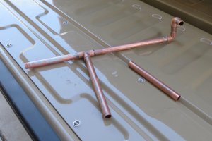

The worker was installing the copper pipe at a second floor bathroom. Just about done, he was. I saw that he was fixing to insert and solder the six inch piece in the picture. What I didn't see him do was ream the pipe. I summoned an English proficient translator and asked the worker if he reamed any of the pipe. The workman immediately started to ream the pipe with a razor knife. As it turned out the workman stated that he did not ream any of the pipe. The copper pipe was nearly completed and I wrote a correction to start over. I expect a pail of fittings and I will be cutting out a random spot or two. I took these for proof of the violation.
