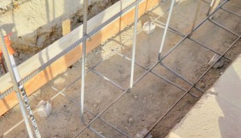

Take a look at the work.
This is from the approved set of plans.
It is mislabeled as a tank anchorage. The footing shall be 12" into undisturbed soil. The re-bar shall be 3" away from soil. On this page the wall is maxed out at 9'6". Another page has 10"2". I doubt that 8" is a big deal....it's sloppy.
The footing is 12" deep from the middle of the slab on one side and 0" deep on the other side. The re-bar is supported on the wrong bar.

The plans also indicate 4 rebar in the footing and the picture only shows 3
The plans call for a #4 on each side. The rebar in the middle is an extra on the drawing. Looking at the rebar in the wall there is supposed to be a horizontal rebar every 32” but the drawing places rebar about 12” apart.

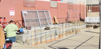

On the "day tank anchorage" detail (CMU wall), do you ever inspect the keyway between the foundation and the wall? Having the keyway is more work for the contractor. With #5 @ 24" vert passing through the joint, the keyway is probably a waste of time. But, it is shown on the approved plans. Is the keyway dimensioned on a typical detail or note?
ICE,
I asked for printed pictures of the keyway and allowed them to erect 4’ of wall before the next inspection. The #5 rebar are spaced 16” apart. There is no dimension for the keyway. They will use a 2”x4” block.
