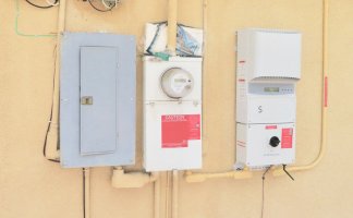

Is the receptacle in the side of that service normal?
I have never seen that done like that, could that be a knock-out opening in that location being used for the single receptacle? Seen many a handy box attached to a panel in a basement. Seen a electrical panel dead front cutout and rigged with a duplex receptacle which was nicely done.
Agree with mark's opinion, not usable and not meeting code for lack of GFCI including wet location cover. Could it ever have been a legal install? I think no!

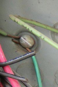

Nope, it's a mounting screw. I pretty much condemned it all.
Solar companies will attempt to energize darn near anything and then play dumb when I say no.
