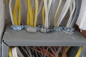

This is how I found it. The worker was out front in a truck waiting for me. This was the fourth time this week that a panel was left like this and there's one more day to go.
I couldn't see the top because I'm old and crippled as you can see me there with my canes. So I took a picture. There isn't a hub but it looks normal enough.
Whenever there is no hub I want to see inside.
And there it is.....an intact KO.
Update: Friday was a new day and it happened twice. Six times for one inspector in one week. There is at least 500 inspectors in socal. I'll be conservative and estimate that they each encountered this once in the last week. 500 chances to kill someone....every week.
It is an embarrassment of epic proportion.
The guy that left this open was in the company van. I’m not good at hiding disdain for the guy that left this open. Six times a week...it gets tiresome to rant with no reaction from officials or the industry. No informed person, there are many, denies the danger. It persists. I can’t get away from it. Sometimes I ignore it comepletely. There it is....open wide and the guy that left this open and went back to sleep is right there with me and I don’t even mention it. He just thinks I’m the meanist inspector he’s ever encountered. Sure he’s heard stories, but now it’s him

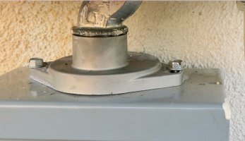

The offset has straight threads and the hub has tapered threads. It is obvious by the damage that it was forced. I have done an experiment and found that water gets though readily.
Beyond that, I'm not convinced that this hub is listed for use in a wet location. If anyone has knowledge regarding that please share.
If that hub is the type I'm thinking it is it isn't approved for outdoor usage. There is no means for sealing it to the box it is mounted on. It's just flat on the bottom, even if you put some type of sealant between the 2 flat surfaces it probably wouldn't seal well. They are only approved for interior usage and I believe some area study would approve them for that.
