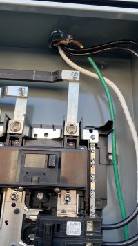

The setup prior to the solar contractor messing with it had two circuit breakers that powered a swimming pool. Being at the end of the busbar, they had to be relocated. 20200824_172013502_iOS.jpeg
The problem that I have with it is there is no pair of breakers labeled swimming pool. The solar breaker took the place of the swimming pool breakers and the guy that handled the virtual inspection is clueless. The correction states that GFCI protection is required.
This how I wrote that correction:
The previous circuit labeling had two breaker slots identified as "Swimming" "Pool". Those slots are at the bottom of the busbar. The solar breakers have been placed at the bottom and there is no pair of breakers labeled swimming pool. Please explain this and label the circuits correctly.
Furthermore, I must assume that the missing swimming pool breakers were GFCI. And therefore will be replaced with GFCI. I could also assume that the previous breakers were not GFCI. In that case, because they were removed from the busbar they shall not be reused and GFCI protection is required.
