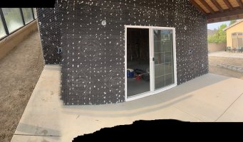

yes and yes#4232 photo. Is there a violation? Is the chicken wire going the correct way?

The intent is to provide power to an ADU.ICE, Post 4,248, any back story on this? Need more information before I scrutinize the caption.
So.....SER underground......The intent is to provide power to an ADU.
Column 3 ....under minimum 4" thick concrete slab....so it is deep enough.....however it is NMC that is not allowed in a wet location......the conduit is schedule 40 and shall be schedule 80 where it is above ground...the conduit is too small in diameter for the eventual conductors.....the pull box is too small and shall be inset into the wall.So.. what column and method from table 300.5 would address this application?
Ridged nonmetallic raceway below a sidewalk?
Service to ADU size?
