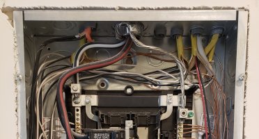

Correction was written to isolate the neutral from ground due to this being a sub-panel. There is two of them.
I write those corrections all of the time. I even make them completely remove that green "jumper" screw. Blows me away that seasoned, licensed, professional companies have been consistently doing it this way for way too long. "I've been doing it this way for 30 years" or "the county lets me do it." Don't care, doesn't make it right.
