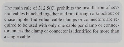

312.5(C) Cables.
Where cable is used, each cable shall be secured to the cabinet, cutout box, or meter socket enclosure.
This is from the handbook:
This is something that every electrician should learn early in their career. If they learn it from me it’s a bitter pill to swallow. I am okay with that. The rub is that it can be such a bitch to fix. The workman wants to hear from me why fifteen cables in a clamp is a safety issue worth the grief. I hear, “Can you let it goe this time?” If I let it go this time why would the correction have any merit next time….and there will be a next time.

Commentary from the handbook is not enforceable, & there still is no way to do what you are saying with a large number of cables, there is physically not enough room to have individual Romex® connectors. Might be time to ban that style of panel.
The handbook is someone's opinion of what is enforceable. There's two ends to the cabinet and both ends provide KOs. On top, or bottom, of that is the use of a Greenlee punch.
If that cabinet won't work....oh well....try another.

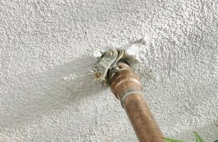

The inspection was for a final of a water main to an apartment building. The pipe size has increased so the original ground clamp is too small. For that reason, the plumber ignored the clamp. I had to tell him to replace the clamp.
The plumber installed almost the correct clamp. It is not too much worse than the original clamp so it is acceptable...well that and the armor is short. I then had to tell the plumber to seal the wall.
He took care of it. The clamp picture and the caulk picture were sent to my phone so no return trips were necessary.
