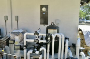

Nice pool.
Somebody is going to be disappointed. And don't you know they will say, "That's where the plans show the equipment." The implication will be that it is the fault of the Building Department for approving the plans.
Nice pool.
My first drafting job was for a pool company. I don't recall ever having to note where the electrical meter or panel was. The biggest issues the jurisdictions were worried about way back when was proximity to the property lines and the house.
You are correct. I never see that on a plan. I convinced the last County office that I worked in to require the plans to show where overhead utility service drops came on to the property. You could get some idea of where the panel was located.

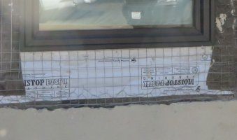

As I walked up to the building I surmised that the windows were improperly flashed. It looks as though the flashing is over the nail flange.
Even as I got closer.
I wrote a correction and as I was getting ready to move on a lady drove up. I say lady to be nice but most men are less profane to my face than she was. I was informed that I was incorrect. So I got real close and discovered that the nail flange is white and white caulk has been applied over the flange.
