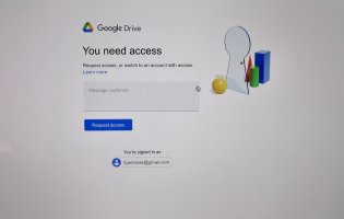

I can't get the link to open.
Hmm. I can't seem to upload an image. Not sure what to do ....I can't get the link to open.
