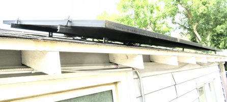

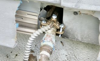

The inspection was for solar....but not this solar array. This array was previously approved along with an electric service panel upgrade. The PV wire is laying on the roof. There is an armored GEC running under the rafter tails.
They pointed out that the ground clamp was in bad shape so they replaced it.

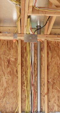

Big bundle in a big hole.

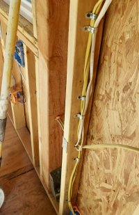

One pipe clamp and one drywall screw.

ICE, I am curious... when you do inspections, do you call out violations as you see them, or do you make a list and hit the worker/contractor/owner with a big list all at once at the end of the inspection?
Depends...Could come out of stackers too...It only needs to hold the cable until the drywall goes on....And then it does not need to be supported at all...
The only NEC section that specifically addresses this particular situation is 110.2. If they bent the fitting a little so that the NM cannot feasibly escape, it is both supported and secured. There is no requirement to use any particular method of support, or even a listed method of support. 2020 NEC 334.30.
NM is allowed to be fished in concealed spaces where you can't get in to support the cable without removing drywall per 334.30(B)(1).

Look at the pictures. The electrical work was a cluster of corrections. As to the pipe clamps....they are everywhere and the few staples that I found were over-driven. I told them to remove the pipe clamps and I explained what 4.5' on center means. I had to school them about bundling, cable clamps and shear walls and why the foam is only supposed to be used at plate lines. So yes the pepper is cleaner but I still wouldn't use it.
