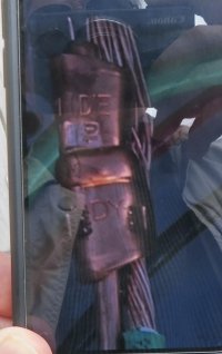

Solar contractors always have pictures of the roof top junction boxes. I don't go on tile roofs. So I end up with a cell phone screen showing me the work. I wrote a correction for this ... then the worker said,
"Oh my bad, that picture is from another job."
