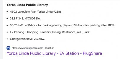

The location is the Yorba Linda Ca. Library/Town center parking lot. Noon on a sunny Friday. I suppose I didn't need to mention "sunny". Probably 150 cars in the lot. There is room for 15 EVs... two are hooked up. I didn't get close enough to see what the city wants to juice your ride. They're gonna be in the red until at least 2099.
Then there's the five "CLEAN AIR" stalls. The only redeeming part of that is the stalls are at the farthest point away from the building so the driver gets to breathe polluted air longer than us DIRTY AIR drivers.
