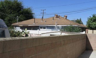

I wrote a correction that stated that the flex vent is not listed for outdoor use.
I noted an ongoing project fifty feet away that has the same flex vent used outdoors.
I said that the project is ongoing due to a lack of paint. This city requires everything that's not a part of the house to be painted to match the house.
And right next door. They do like their paint and the city is not all that particular about where that paint is placed.
I have a question or two regarding the correction that I wrote.
I have looked at the installation instructions for several manufactures and they are dramatically divergent. One states that the flex vent can be used anywhere a single wall vent is allowed with a reduced minimum distance away from combustibles of 1" and it is not allowed in an attic or crawl space.. Another states that their flex vent is only allowed in an attic or a crawl space while being Listed B-vent.
So far I haven't seen specific verbiage that would prevent an outdoor installation by any manufacturer. I did see one instruction that stated that each end of the "connector" shall be secured to something such as an appliance or a fitting/vent". So by virtue of that instruction, this configuration is not allowed. It would be nice if I knew which company has that rule.
From the beginning I've had the understanding that this hardware is a connector. To be honest, I didn't get interested in flex vent until now....or if I did, I forgot about that.
The easiest way to deal with this vent is to establish your own hard and fast rules. Or I could find/have installation instructions to refer to.......you would have to do this out of the view of the contractor. There's no point in confirming that you're crazy. I'd like to see the look on a contractor's face when you tell him that the flex vent that he used in a garage is Attic Only" Come to think of it, that vent might be labeled "Attic Only". Who do I need to call to make that happen?

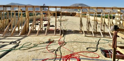

The request was for roof sheathing.
I had not been to this site previously. There's four floors with crap everywhere. The contractor thought that I would sign off the roof sheathing with no consideration given to the framing that holds it up. The condition says a lot about the lack of respect for the inspector. They didn't even have a framer or plans on hand for the inspection.... just a kid with a hard hat.

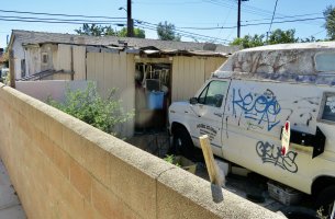

The request was for a gas pipe pressure test. According to the son of the owner, there was a fire two years ago and the dwelling has been vacant for the two years. The son was a few bricks short of a full load so the why it took two years wasn't clear. He said that the work inside is done and the gas company will not restore service until the building department gives the okay. I don't have confidence in the inspection crew in that city.
I was saved by the gauge which read zero. Nobody has said anything about the mountain of garbage in the back yard. I alerted the ASS-BO.

I notice things that influence my attitude in dealing with an inspection. The job is a four story hotel. The place is a mess with left over material and falloff. Each floor has a stairway landing. There is what someone thinks are guardrails. The attempt to restrain a 200 pounder that stumbled down the stairs is woefully inadequate. The elevator shaft was a message to wear a hard hat.
So that and the trash gave me a sense to not approve anything unless I had to.... and I've never "had to" before.
