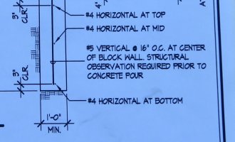

The previous inspector didn't approve the footing because of the steel pipe. The pipe is shown as is on the plans. The pipe will serve a drainage inlet. This is the last 40' of a thousand feet of subdivision wall.
I was given the inspection. This is the footing detail for the typical wall.
When I asked for the structural observation report the contractor was surprised. I can't recall ever having a structural observation on a block wall. The engineer might be upset to find out that 99% of it was done without him/her/they-them.

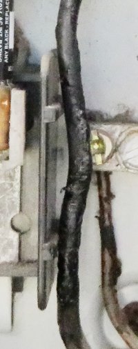

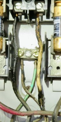

The unit and it's disconnect.
i had to get on my knees and even then it was not possible to see the inside of the disconnect so I took pictures.
Looking at a little screen on a camera is not much good.
I get the pictures into a computer and then I can see clearly.
This did not happen:

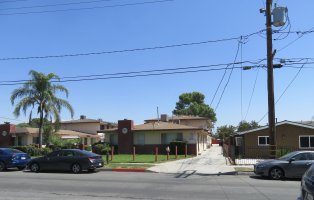

The inspection was for solar. As I walked down the street I saw this:
As I got closer it looked like this:
At the front door I couldn't see a work truck. The owner pointed to a red car and said that the solar guy is there. I found him sound asleep. I knocked on the window. In a sorta panicked voice I told him that there's a dead child next to the live el. service panel. He became upset when he realized that I was twisting his nose.
