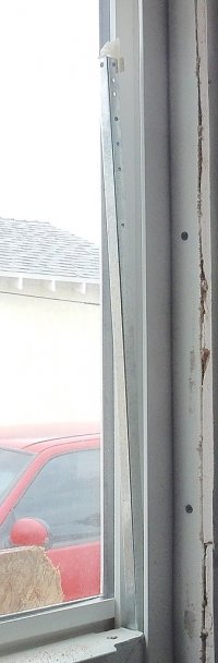

On this job, I was filling in for another inspector. The inspection request was for drywall and lath. The bedroom windows open 21" high. There is a 3.5" plastic stop at the top that can be removed which will allow the window to open 24". Flipper was there and he removed the blocks and shoved the window wide open.
Then there was a load sound and this metal didn't retract with the window.
There's a piece of vinyl stuck on the end.
Here's the thing with that block. When it is taken out the window will open further but it will not stay open that far unless you hold it open. If you are trying to crawl out of the window you're not going to hold it open. You will have 21" no matter what.

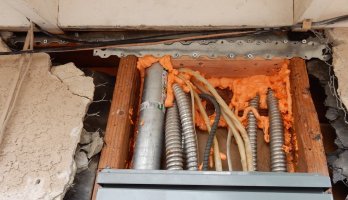

Post #1357, pic #3, a little dab will do ya!, "there, the draft has been stopped?"

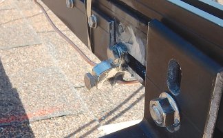

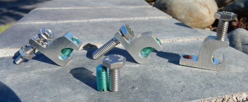

The first lug on the left is an Ilsco as it comes from the factory. It is a GBL-4DBT and is listed UL 2703. The installer didn't like the bolt that came with the lug so they drilled the hole large enough for a 1/4" bolt. Next, they replaced the set screw with a bolt. The threads are different so the bolt cut new threads as it was forced in.
Here is how it turned out. Notice that the lug is mounted over a channel. That was done in an effort to keep the lug as low as possible for holding the copper wire away from the aluminum. There's not more than 30 done this way.
The crew was four men. They have a big company van. They have been installing solar systems for quite a long time. They didn't know anything about a WEEB ban. They didn't know anything about keeping the copper away from aluminum. We gave them a cut sheet that shows how to install Ilsco lugs....and they did this.
"But we didn't do that". I heard you the first time. I didn't say that you did it. What I said was, "This needs to be fixed".
Just Like I didn't say that the tear-off crew threw away the rest of this. What I did say was, "This needs to be fixed".
