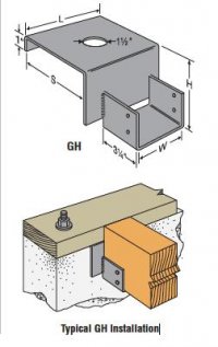

This is the hanger that is called out on the plans.
Obviously that would not work so I suggested that additional pier and posts would solve the problem. But they left out the 18"x18"x18" footing which they have on all of the other posts.
ICE, I prefer the one that was called out on the plans!
Your new design just does't quite do it for me. ;)
