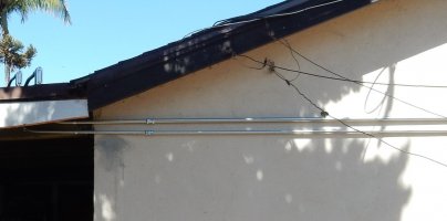

The conduit is 1.5" above the roof for about 30'. I wrote a correction to de-rate the amperage capacity of the wire because of heat. The contractor keeps telling me that there aren't too many wires in the conduit. I keep saying that is true but....I'm not getting through to him.
I have a mantra for dealing with certain contractors and designers who are ... liberal ... with their interpretation of the code: It's not necessary that they agree, only that they comply.
Most people want to do good work and build good buildings, so I can just explain how building it to code is better than what they had done. They see the advantage and build that way from then on. Other folks need a little more "motivation" so I save this for them.
