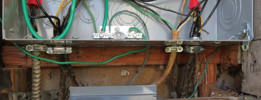

HVAC contractor did an electric service upgrade. The company has a C-10 license.
This is proof positive that a license doesn't mean much these days.
The correction stated that pucker is not allowed.
Sometimes pucker can't be helped.
The electrical contractor gave me a picture of the structural strap that he installed. It seems that the HO was all over him to get the stucco patched.
Part of me would be puckering if I was cutting that service drop!.....But I believe it would refer to the buckling of the insulation on the inside of the bend that is too tight. No code section though...It exists, I just don't have it...
300.34 Conductor Bending Radius. The conductor shall
not be bent to a radius less than 8 times the overall
diameter for nonshielded conductors or 12 times the
overall diameter for shielded or lead-covered conductors
during or after installation. For multiconductor or
multiplexed single-conductor cables having individually
shielded conductors, the minimum bending radius is 12
times the diameter of the individually shielded conductors
or 7 times the overall diameter, whichever is greater.
