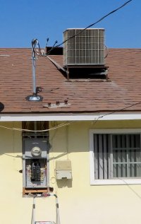

I was there for a service upgrade.
I'm pretty sure that the condenser is just sitting on the roof.

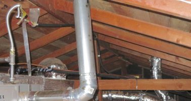

1) Rafter ties at 48" missing
2) Ceiling Insulation missing
3) Flue clearance to combustibles
4) Flue support missing
5) Furnace power supply by plug in cord
6) Electrical connections in last photo?
What else?

Tiger doesn't say but I assume the permit is to change out an attic furnace, can permittees really be forced to add insulation when getting a permit to change out a furnace?
conarb,
Probably not, the homeowner probably exclaimed "That was existing!" Same with the rafter ties, existing.
Believe it or not there were a lot of contractors not installing insulation in garage attics here. Who looked in the attic anyway? They were more goggle eyed :rolleyes: and sidetracked about that $2,500.00 front door that the Architect put on the house plans and the contractor installed!
I use Tiger's photos to improve my Inspectors eye, hope others are doing the same!
The insulation is on the ceiling not the the roof, and just guessing but if the unit is in the garage then that is not conditioned space did not need insulation when the home was built.
Post #2201, photo #2 shows no attic insulation on the Ceiling drywall. Is the photo over a garage or conditioned space?
