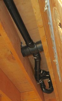

The inspection was for under-slab plumbing. The contractor stated that he will straighten the vent with a 22˚ elbow.
The correction said to remove the foam wrap for inspection and redo the vent so that it is plumb.
I wonder how a 22˚ elbow would have looked.
