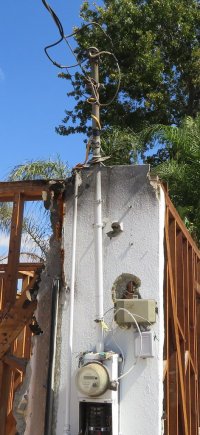

Twice this week I had to ask Edison to roll up a drop.
In both cases the dwelling is not occupied so I didn't go through the office manager. I'll probably get chewed out ....I've been chewed out before.
That last photo, is that the POCO's assumed 200-amp service connected to a cable connected to a box and receptacle with no over current protection?
