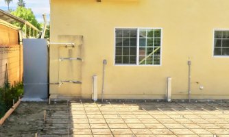

The job is a covered patio. It is 18'x38'. When I asked why the steel stopped short I was told that the concrete beyond the post is sidewalk and not patio slab. The contractor is aware that sidewalk on private property is exempt from permit and/or steel.
There is sidewalk on both sides. There used to be a pair of A/C condensers sitting next to the house. The water heater will be replaced when the slab is there.
The condensers were placed next to the property line There is no electrical or mechanical permit. The conduit and refrigerant lines that are buried were not inspected.
There's bound to be some unusual considerations. The tube will need protection.

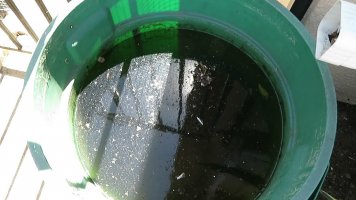

Mosquito larvae swim in a counterclockwise direction.
The picture is an action packed video.
