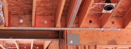

The job is a remodel. The steel beam is shown as "existing header" on the plans. The rafters on both sides are new, as is the header in the distance. The I-beam is 6"x6"x16'. The engineer has approved this work via a Structural Observation form. I asked the contractor if the engineer performed calculations on the I-beam and he said yes but he lacked proof. I asked that the engineer do it again.
I mentioned the strap and was told that the engineer required it because the top plates do not overlap. That was easy to accept but asking for 36 nails on each side of CS20 seems odd.

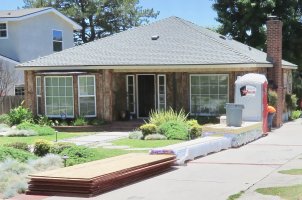

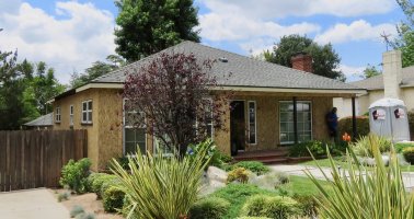

Before:
After:
The job is remove existing siding and install new siding. The before picture was before any inspections. The walls were insulated and sheathed with osb. None of the wiring or plumbing was protected prior to sheathing and they had great pictures of the insulation. The insulation was inside out.
The after picture is after the sheathing was removed and the insulation was corrected. They still had not protected wiring or plumbing. They will.
when the strap fails between the first 4 nails it is a failure due to strap says the engineer
