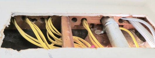

It is always like this to one degree or another. This damage calls for a 5' structural strap wrapped around a corner. How often have you asked for that correction? How about the integrity of a fireblock?

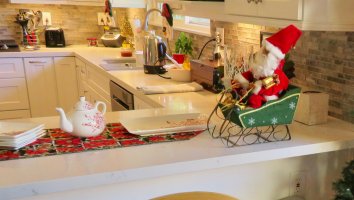

The job is a kitchen remodel. I was there for a final inspection. The three receptacles in the picture are all that's there. Two are missing....on both sides of the sink....missing not by inches, but by feet.
There is a receptacle where it can't be....under a counter with an 8" overhang.
There's three posts that must be done over. You've got to wonder how it got this far.
The receptacle CAN be there....Just not if it is the required countertop receptacle....;)

The contractor went to the office to complain about me. He demanded a code section for each correction. The job is just one room and he only got eleven corrections so I don't understand why he is so upset.

The wall in the picture is not a bearing wall so the hinge is not a concern.
Why are all the pipes running down into the slab and looping right back up? Did somebody think that they're what is bracing the wall?
