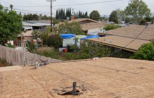

It's about the service drop being a few feet above the roof and the phone line laying on the roof.
