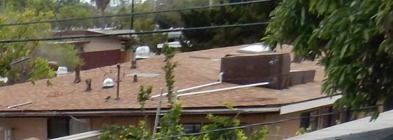

I was there for a re-roof final inspection. Somebody removed and replaced the solar.
This too.
Another suspicious roof top unit in first pic, see brown comp shingle roof, can you zoom in with enough resolution to see the unit?
Not clear but I will be there again and get a clear picture.

I wonder how you get away with shingles on such low sloped roofs.
I think they call that a flexible appliance connector, not to be confused with CSST PIPE.
It is stretched pretty tight and no way would that resist seismic sitting on a couple of 4X4's
Do you verify the pitch with a smart level and does the shingle manufacture allow that low of a slope?
It is a problem in our climate because of ice damming. Your climate might be wind driven rain. Oh wait you live in a desert if I remember correctly
Yes I use a Smart level. I've had it for twenty years or more. The shingle manufacturer will allow shingle on 2" and up.
It rains here....a few times each year.
