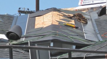

The contractor blew in from Arizona. They rode a wave of government rebate monies for solar water heaters. They have a top notch front office. They have never passed an inspection the first time out because they have no plumbers/carpenters. The heating element is a tank on the roof that, when filled, weighs 650 pounds so there is always a purlin to be installed. They never do that part unless I make it a correction. About half the time, there is nothing to land a purlin brace on.
I don't know if the train ran out of gravy or they realized there's an easier path to riches but they quit taking out plumbing permits and have started taking out electrical permits....for PV. There must still be 40 permits for solar water heaters that have languished and I am but one office in SoCal.
The only one that I have inspected is a four module system that resulted in 12 corrections. It was bizarre. Nothing on the roof was grounded. I fear that they will get a workman killed.

b. Panels continuous over two or more spans with long dimension (strength axis) perpendicular to supports. Spans shall be limited to values shown because of possible effect of concentrated loads.
c. Applies to panels 24 inches or wider.
This job is a re-roof over skip-sheathing.

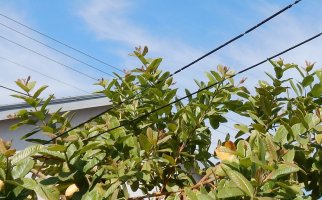

One of the benefits of getting a building permit for a re-roof. These wires stretch between the house and detached garage. They are low enough that I could reach them with my tester.
