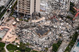

This is an interesting pic. Note the slab punch through on the column. I may be just an electrician but I have installed so much conduit in these type of structures that the amount of reinforcing steel sticking out of this column just seems to be less than what I'm used to working around.

I'm having a hard time picturing what that rebar was doing. I initially thought it supporters the deck but then the overall view shows that it wasn't. They certainly didn't pop out of that column and I'm sure the column have much more rebar in it than that based on some of the drawings we've seen elsewhere.
The columns look to be intact at 72/73. I think that rebar is just pulled out from the parking slab that dropped four or five feet leaving the rebar looking like it is part of the column.
Is it possible that the rebar from the column's attached to the floor slabs by tie wires? (guessing here) is not an adequate way to connect the slab to the post if they can pull away like this. The rebar looks like they have been stripped clean by the slab drop.

I am having a hard time wrapping my head around how this happened without some sort of external catastrophic event. Nothing I have read (of course I haven't read it all) seems like it would cause the collapse without significant warnings. I think one of the engineers who evaluated it even said the same thing about the defects he saw. My first thought was sink-hole, but I have seen nothing to indicate that. It is telling that the apparent garage deck punch through occurred adjacent to the sections that collapsed but didn't have any apparent issues from above that level. Maybe it was a result of the stress from the adjacent collapse. I sincerely hope valid warnings were not ignored....by anybody.

I like the garage failed theory , than pulling down the building
So if I were to speculate based on news reports which included interviews and photographs, I would concur. Column failures in the garage near and/or below the building. Years of neglect and salt water intrusion. Again, this is speculation and we know it will be months before a report is released.
Comment from engineering forum that really hits the mark when you see the amount of rebar that just pulled out of the concrete:
The complete degloving of rebar is very concerning and makes me question the ductility of older reinforced concrete structures. There could be many reasons for this degloving; I don’t know how much how quickly a load is applied effects this, significant rust or millscale on the rebar, etc.
