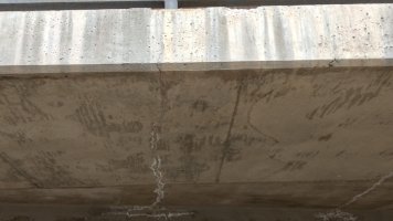

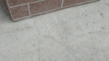

I walked by this building at lunch. It is two years old, a 4 over 2 podium. These cracks with obvious water intrusion are every 8', some over control joints, some not. The exposed rebar occurs about every 4'. This area is a cantilevered walkway on the podium level outside the parking garage. What will this look like after 40 years?
