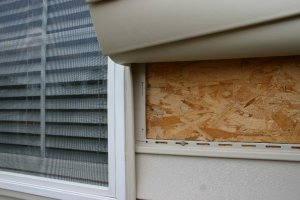

It's a bit early to push my red button, but here it goes.
Some people do their job and others look for excuses not to. Seriously, how lazy do people choose to be?
Because you know how much I love to debate....Too lazy or too busy? FYI, we do not do a roof start or siding start nor sheathing inspections... .....So let's say I have 5 inspectors and we do 10,000 inspections a year doing the minimum inspections and we schedule about 2 weeks out...How do I incorporate more inspections? Go 3 weeks out? Convince the municipality to fund another inspector or 2? If I can't convince the municipality of the value of doing my job better (protecting lives and the grand list), I have no chance...They just keep us as a cash cow...

The point of the thread was to show how ineffective a lazy inspector can be and the long term results that are possible.
