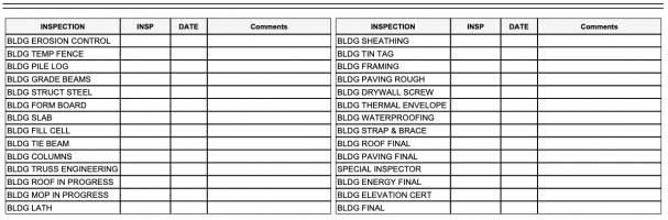

This is a permit inspection card for new SFR construction. This has nothing to do with windows, or any MEPs, just structural only including roof.
Transitioning from a career as a building contractor to a building code inspector might seem like a significant change, but there are several logical and compelling reasons an experienced contractor might consider such a move:
