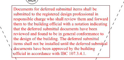

The DPOR's stamp is not for taking professional responsibility for the design of the trusses, it taking responsibility solely for checking for conformance with the information already given by the DPOR in the original permit set of plans.
From the AIA docs - - I think paragraph 4.6.4.3 is describing a true "deferred" approval of a design-build component:
