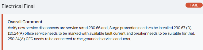

This is for Jeff as I know how he likes these....how many violations do you see in this service disconnect? Does it matter if it is a dwelling unit or not? Lets say 2020 NEC......Go!
I see two right off the bat if that is a service disconnect and possibly a third. I will review and respond when I get home.
There is at least one requirement that is for dwelling units and not others and one that is for non-dwelling units that does not apply to DU...But maybe CT amends that.....We will wait and see if anyone else chimes in...
Soooo????

So, unfortunately, I was up on my roof after work trying to fix a leak. Sooooo, here it goes:
1) I would want to verify the connection of the completely unnecessary lug's compliance with 250.8(A)(5)
2) If 250.8(A)(5) is not compliant then I would add 250.12 to the mix
3) The most obvious, and most common problem I see is 250.24(A)(1)
There are my possible 3, but definite 1.

So here is how I wrote it up:
The surge protection is required for dwelling units but not other than, available fault current is other than dwelling units, Jeff nailed 250.24 (GEC to utility grounded) and common here as well....I got back to the office and realized that I actually didn't verify these were service rated (there are 3) and the breaker in one of them was only 10kA rated.....Thank you for playing our game and Jeff has some parting gifts for you out back....
