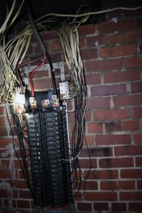

The Official Electrical Violation Photo Thread

As far as that WH install with cord and plug, that looks like a violation not having the correct disconnect unless that meets the WH manufacture requirements. Doubt it!
There are some small squat size WH's that have a built-in cord and plug. (Rheem makes one).
box fill, nm securement (zip tie to stud) if at all, grounds, insulation, extension of existing circuit - 14 gauge wire may require overcurrent device to be changed out to 15 amp, possible recess of box (look flush to stud) , excessive wire protruding from box - (generally limit to 6 inches ROT),
4 x 4 junction box, might be using a plaster ring for the devices to be installed, but not on site
The sky is cloudy with a chance of rain and I want to go fishing..... that I would say is the biggest issue.
So are you saying the cable is not "secured" to the box with the plastic clamps? Because it looks like there is more that 1/4" of jacket inside.....
On another note, is the draping of the plug wire across the top of the WH a concern?
Would have been better if the outlet was to the side of the WH and accessible, no?

Looks like it is wired per code??? not sure the problem
