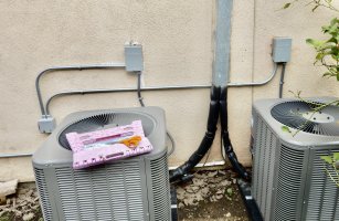

The line set chase should be vermin proofed with hardware cloth. The condensate drain should not terminate over the equipment pads on the two units to the right.
The raceway should be secured and the fitting is not tight to the disconnect enclosure.
Conductors have been brought through the back of the disconnect enclosure. There is an obvious question as to how that was accomplished. In addition to that is whether it is water tight or not? There is no evidence of caulk at the top and sides of the enclosure. The same questions apply to the receptacle and why is it mounted sideways? Is that how the cover keeps out water?...and that cover, is it an in-use extra duty cover?
It doesn't appear that the condensers are secured to the concrete pads.
The arrangement of the condensers has made it difficult to service the units.
Do you have pictures of the inside of the disconnects?
Some of those low cost pull out disconnects would require the caulking to be removed to access them for service, because of the way they are designed and since they are equipped with standoffs to give a 1/4" airspace, I would say it is a bad idea to caulk them.
These disconnects are not them. If caulk at the top and sides is missing, water can get in the wall cavity and the disconnect enclosure. It can be done with a close nipple and a tight fit at the siding with caulk but the usual is out of sight, out of mind,
Here is an example of the typical method. Notice the zip tie stuck in a screw hole and the evidence of the hole at the other screw hole.
It's always HVAC guys doing the work. The truth is that a competent HVAC mechanic is right up there with the best electricians when it comes to smarts.... but just not smart enough to leave the electrical work to the plumber.
These guys get an A- for effort.
In the long run, caulk dries out and becomes a ribbon. Water gets in and we don't live in a perfect world. It probably happens fifty times a day in California and nobody really cares.
