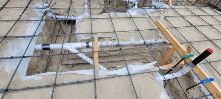

Yes they are to be accessible and we typically see them inside the foundation.
Outside the foundation they have to provide a larger pipe cyinder and a way to pull the flapper devise out. The one in the photo, I'm not sure how you access it?

The inspector was there for a footing/slab inspection. The under-slab plumbing has been approved by another inspector.
