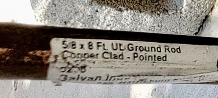

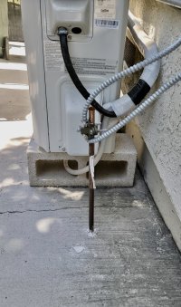

250.53(G) Rod and Pipe Electrodes.
The electrode shall be installed such that at least 2.44 m (8 ft) of length is in contact with the soil. It shall be driven to a depth of not less than 2.44 m (8 ft).
This was done by a licensed general contractor. There is ample evidence that the contractor should not be performing electrical work. Had anyone involved known much about the electrical code requirements the rod would be driven to a couple inches above the concrete. While that is short of 8' it has been an accepted practice forever.
The label is the true indication that they are clueless and not because they didn't read it. Since the label is present, the typical reply, "That's a ten foot long rod" will not suffice as usual. They didn't know that there is a ten foot rod available and perhaps they would not lie even if they did. Now the GEC and armor are too short but luckily, there is just one rod.
Besides the rod not driven far enough, do you have testing results of 25 ohms or less so that they can only drive one rod? See 250.53(2) 2017 NEC. It also looks like that condensing unit may be supplied with flexible cord, but can't tell for sure.
They wouldn’t know what an ohm is. The lucky part of the single rod is that there is less wast of #4 GEC and armor. But looking at the picture I think that I could be wrong about the single rod. The GEC doesn’t stop at the rod. ….but maybe it continues to the water main. Who knows….
The picture was sent to me by an inspector and the condenser was not mentioned by him.
They wouldn’t know what an ohm is. The lucky part of the single rod is that there is less wast of #4 GEC and armor. But looking at the picture I think that I was wrong about the single rod. The GEC doesn’t stop at the rod.
250.53(2) still applies, no test a 2nd rod is required & is the quickest & cheapest way to comply, the testing equipment is expensive and need to be qualified to perform the testing.
I can't say that I have ever seen a grounding rod set that high before, looks to far out in the pic to have hit a spread footer? The ground rod indicating 8-ft is diffently calling out ....WRONG on the install.
