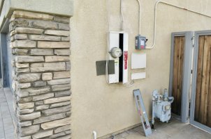

I have to wonder why the receptacle was placed next to the recently installed waste pipe which is not a cleanout fitting.
Solar contractors just don't care.

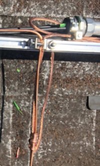

The installer sent the second picture to show the mounting of the equipment. The Amphenol lay-in lug has two wires in the terminal. There is a cluster of bare copper wire against the aluminum rail. That's two violations that the installer was not aware of.

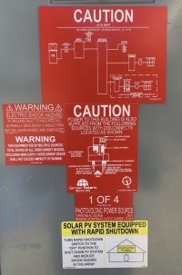

Back in the saddle... Did one day in a city. The contractor is not required to be on site for inspection. Had solar inspections. Upon arrival I found them just like the picture shows....I didn't touch anything to stage the scene. It happens several dozen times each week in southern California. A common practice for years and I am not aware of anyone having been electrocuted. I used to raise Hell about this....I am just one person and nobody pays attention to me.
Not only is the contractor not required to be there for the inspection the inspector is not expected to actually perform the inspection. To the right of the battery control panel is another panel.
