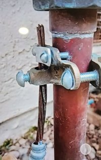

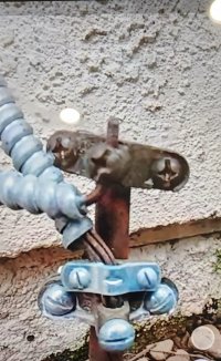

A friend that is an inspector sent me these pictures. He works from home performing virtual inspections. The inspection that he was doing is for solar. The GEC connections were previously approved by an in person inspection of a service panel upgrade.
