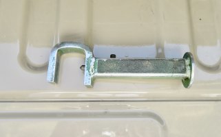

These steps were $50.00 off. They are especially handy when rolling tall trusses. If you find them, make sure to not place the spring loaded pin on a knot.

The green paint is me. I painted all of my tools green. If you had a green tool…it was mine. Guys wouldn't believe me when I told them that I had a ladder that i could hide in my bags.
These steps were on the market during a time when the world was not so complicated. The liability insurance that a manufacturer would need today puts stuff like this out of reach.
What is the small set screw just above the hand?
