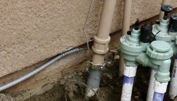

Bond the stucco weep screed and the refrigerant pipes.
Remove and relocate the receptacle.
The contractor was not at the site.
The deadfront for the service panel is on the ground. The service panel door will not close.
The solar company is located in Massachusetts. I called them. I got a call back from the local installer. I unloaded.
This is located at a large project for condominiums. I was there to inspect the installation of the valves. It took an hour.
When it was done I asked them to energize...The water pressure is 150 psi.
Turns out to be backwards. The top has to be removed, rotated and reinstalled. I got a call from the contractor when I was leaving town. He wanted me to return to the site.
