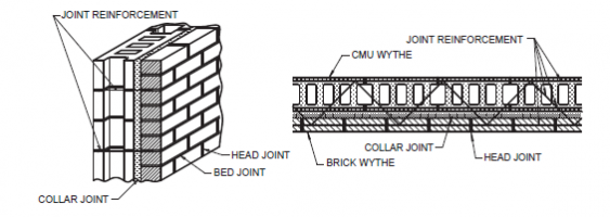

Meant to add not sidetrack this discussion; anyone know why the terms composite and masonry-bonded hollow wall were removed from the 2015 IBC?
So would a 4 inch CMU bonded to 4 inch wide brick be a 8 inch composite wall?
As a reminder 4-inch masonry wall not to exceed 4 ft. is permitted to support a 2-story light frame contruction (see next post below).
WALL. A vertical element with a horizontal length-to-thickness ratio greater than three, used to enclose space.
Cavity wall. A wall built of masonry units or of concrete, or a combination of these materials, arranged to provide an airspace within the wall, and in which the inner and outer parts of the wall are tied together with metal ties.
Composite wall. A wall built of a combination of two or more masonry units bonded together, one forming the backup and the other forming the facing elements.
Dry-stacked, surface-bonded wall. A wall built of concrete masonry units where the units are stacked dry, without mortar on the bed or head joints, and where both sides of the wall are coated with a surface-bonding mortar.
Masonry-bonded hollow wall. A multi-wythe wall built of masonry units arranged to provide an air space between the wythes and with the wythes bonded together with masonry units.
