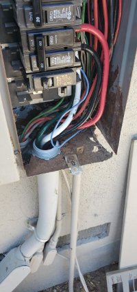

This is on the same panel:
Enjoying the world of virtual inspections. The job is solar and a service upgrade. They send good pictures.
I was curious about the individual wires making it into the panel and the three KO plugs caught my attention.
The plan is to convert this panel from a main panel to a sub-panel, hence the conduit with the fat wire to the 100 amp back-fed breakers. The contractor can't seem to understand why the inspector turned it down. His lament that it is existing and therefor off limits speaks volumes about the contractor.
Is it the rotten enclosure or that the backfed breaker isn't fastened or the re-identified green wire?
There were corrections. Even with no corrections this contractor had no problem trying to use a rotten enclosure.
How can a panel with a permanently bonded neutral be converted to a subpanel? That is a question to be asked, plus the corrosion means a no go to me.
