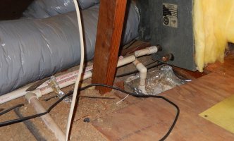

The lady seemed forthright. She told me that a big box store contractor went in the attic to prepare a bid to replace her furnace. He told her that she needed to replace the A/C equipment as well as the furnace. She declined because the A/C has been used only a few times in all the years that she's had it. She wondered if it was ok after hearing his diagnosis so she tried it out. She got a huge water bubble on the ceiling.....but it did blow cold air.
Now another contractor has replaced the furnace and left the condensates cut off. I explained what's up but she is out of money.

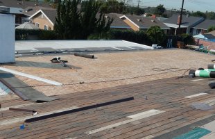

A code enforcement inspector flagged this house yesterday because there were no permits. The contractor came in today and pulled permits. He asked if I would inspect it today. It rained all day but I went there anyway. They wanted me to use that ladder to access the roof.

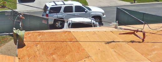

A roofing contractor dismantled a PV system in order to replace the roof covering. He planned on putting it back together....without a permit.
He was convinced that there is no danger because everything is shut off.
Mechanical contractors seldom provide a ladder to inspect furnaces in attics. Many times the owner will say, "wait here, I have a ladder". This one is still wet.
