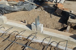

The evaluation report (ICC ESR or IAPMO ER) for post bases often times specify a minimum concrete cover. What do the engineered plans show?ICE said:It's a commercial building. There will be a post supporting a center beam of a flat roof. I was there for a slab inspection. The engineer blessed the work during a structural observation. The contractor was there for my inspection. I said "Oh my gosh, that looks weak" The contractor didn't hesitate and said "Oh my gosh, your right"
The plans show the same post base turned 90 degrees. I don't think that would be an improvement. The entire anchor is in the concrete stem which could easily be snapped off. Simpson allows some radically small edge distances but probably not on both sides. I didn't bother to look at that since the issue is the stem. Not to mention that an inspector approved it and the engineer did too.Phil said:The evaluation report (ICC ESR or IAPMO ER) for post bases often times specify a minimum concrete cover. What do the engineered plans show?
